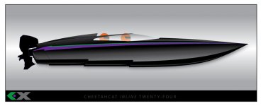

can it be built as a tandem seat?.... would love to show all of my big boat budddies what it feels like to go fast in something small..... I slid in the cockpit of a seebold tunnel yesterday and it made me think about this thing....
I thought I would do a "sketch" of a inline-stagger seating, but I went with an offshore style boat, not paying attention to your reference of the Seebold tunnel.
