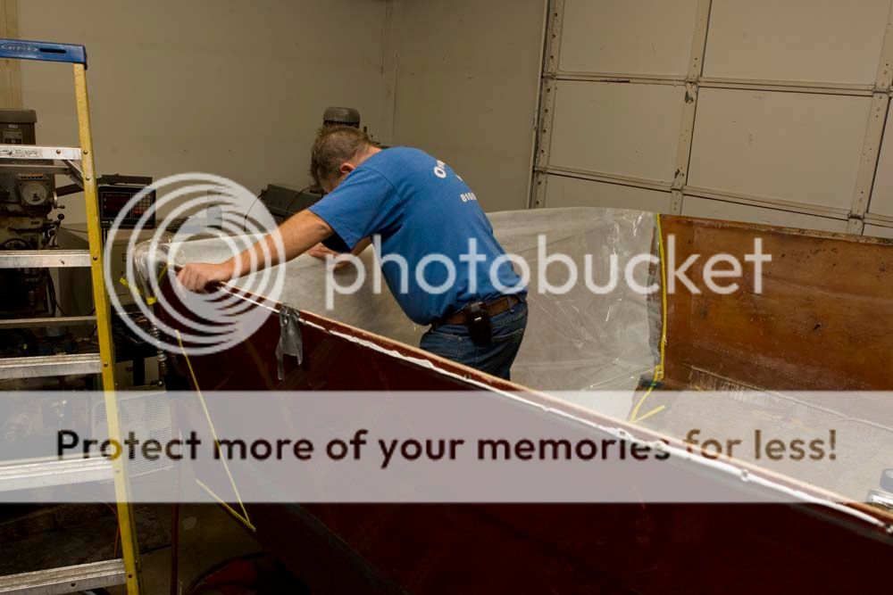

Since I started posting after I was well into the project, here are some shots of the transom install that was done over a year ago.
This post is for Artie. This should make your day! This was...I repeat....was my first attemp at resin infusion. Nothing like starting with a small part to learn on.
Everything was flowing great. The cloth was wetting out nicely. All of the sudden everything came to a screaching halt. The combination of the resin being mixed a little hot and the feed lines being too small a diameter caused everything to kick before everything was completely wetted.
Damn!!

Sadly and very disappointed, I ripped the bag and cloth off the transom before it kicked completely.
I have a Scarab you could give this another try on :cheers2:
Well , at least you tried Infusion , and to tell you the truth i much rather bag something , and just curious was your resin thin enough because they do use resin's that are designed for Infusion alone that have a very watery consistency and i do mean watery . Overall you and your partners are doing a great job and having fun even if the going get a little disappointing at times .
Hey Artie,
I was using a Vinylester infusion resin that was considerably thinner than normal resin. I was given a ratio of MEKP to Resin by my supplier. I asked for a conservative ratio to give me as much time as possible. I am not sure why, but despite making small batches, the resin just took off! I mistakenly used 1/4" feed lines instead of 3/8". I really think that if I had used bigger lines, it would have worked. The resistence in the 1/4" lines made the resin flow too slow, so the resin had too much time to sit in the pot while being fed. Despite the failure, the entire job worked nearly perfectly. The bag had great integirity. The flow pattern was beautiful. The wetout was going great. I was really awesome to watch it work, once the resin started flowing. Again, this was not only my first attempt at infusion, but my first use of vaccuum bagging at all. I really wanted to infuse the stringers too, but did not have the guts to give it another try. I think I will infuse some of the smaller frames just to practice. If it goes poorly, it will not be such a great loss. I really believe that if I were to do it again, it would work. Not to make excuses, but keep mind, I am not a prefessional in this trade, like yourself. I am just a weekend warrior trying to fix my own boat, so I am doing the best I know how. I am glad that you have taken the time to respond to this thread and welcome any advice or support you may have.
