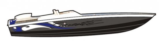

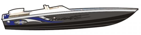

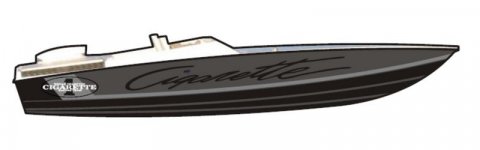

We have been playing with paint schemes..
I still want to keep the lines classic, but a little modern colors may not hurt either.
These were done quickly the other night and will be refined more.
I am sure I will also have some clean sheet ideas as well..
Hard to tell in the pics but the bottom will be gloss black,
The sides are hot rod black and the deck is silver.
Graphic colors will are still open.
Feel free to give input on the designs! (No comments on the hot rod black though!)
There also seems to be some controversy as to whether this is a Cigarette or a Squadron. The info I have shows this particular hull to have come from the Cig factory. I also have ad copies showing the manufacturer as Cig and the model as Squadron XII. The next set of graphics you see will have more Squadron flair to them...
