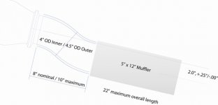

    ILMORDude - CMI is working with me on a set of tailpipes with the mufflers integrated right into them. Tricky project, as I need a 2" downwards offset between the header outlet and the transom holes. (Low engine hatch.)
    GlassDave and I have a busy weekend ahead of us on the transom as well...
    Attached Thumbnails Attached Thumbnails Tailpipes_13Down.jpg   Transom_Fill.jpg

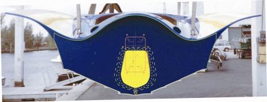

    We had a 100% successful weekend. All the lamination work was drawn up on the computer beforehand, we used templates to cut it all out, and everything fit perfectly.
    Attached Thumbnails Attached Thumbnails P1020371 (Medium).JPG   P1020374 (Medium).JPG   P1020377 (Medium).JPG

    More lamination, vacuum bagging, more carbon, more Kevlar, more 1700 biax, more epoxy. From back to front, the sequence is:
    1. 7 layers of 1700 biaxial S-glass
    2. 1 layer of 7 ounce Kevlar
    3. 1/2" marine plywood inset
    4. 1 layer of 1700 biaxial S-glass
    5. 1 layer of 7 ounce Kevlar
    6. 1 layer of 5 ounce carbon fiber
    7. 1/2" marine plywood filler
    8. 1 layer of 1700 biaxial S-glass
    9. 1 layer of 5 ounce carbon fiber
    10. 1 layer of 7 ounce Kevlar
    11. 1 layer of 1700 biaxial S-glass
    12. 1/2" marine plywood inset
    13. 1 layer of 7 ounce Kevlar
    14. 3 layers of 1700 biaxial S-glass
    15. 2 7" high knees 10" along the floor, encased in one layer of 1700 biaxial S-glass and one layer of 5 ounce carbon fiber
    That oughtta do it.
    Attached Thumbnails Attached Thumbnails 05032006 013.jpg   05032006 017.jpg   05032006 035 (Medium).jpg
